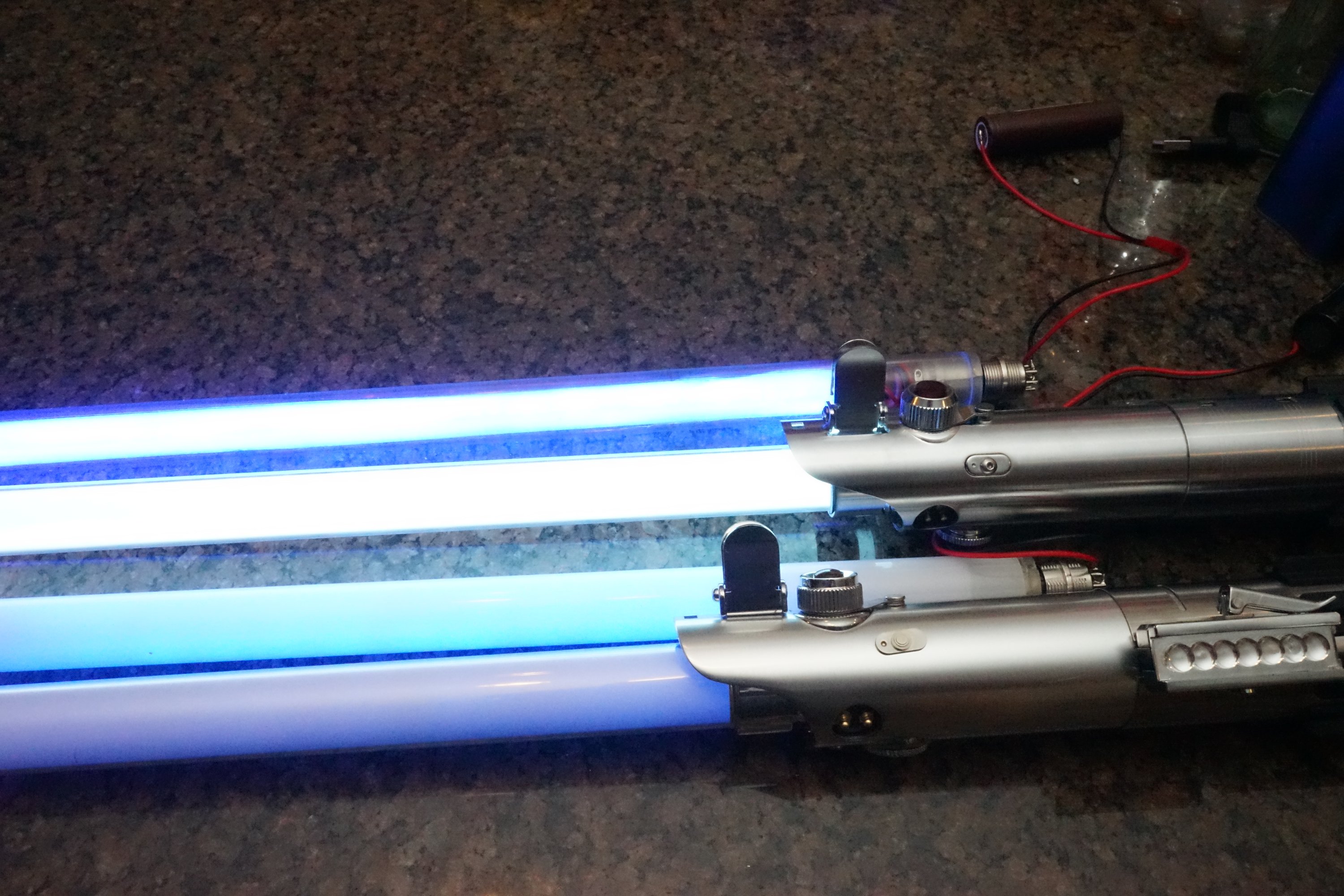

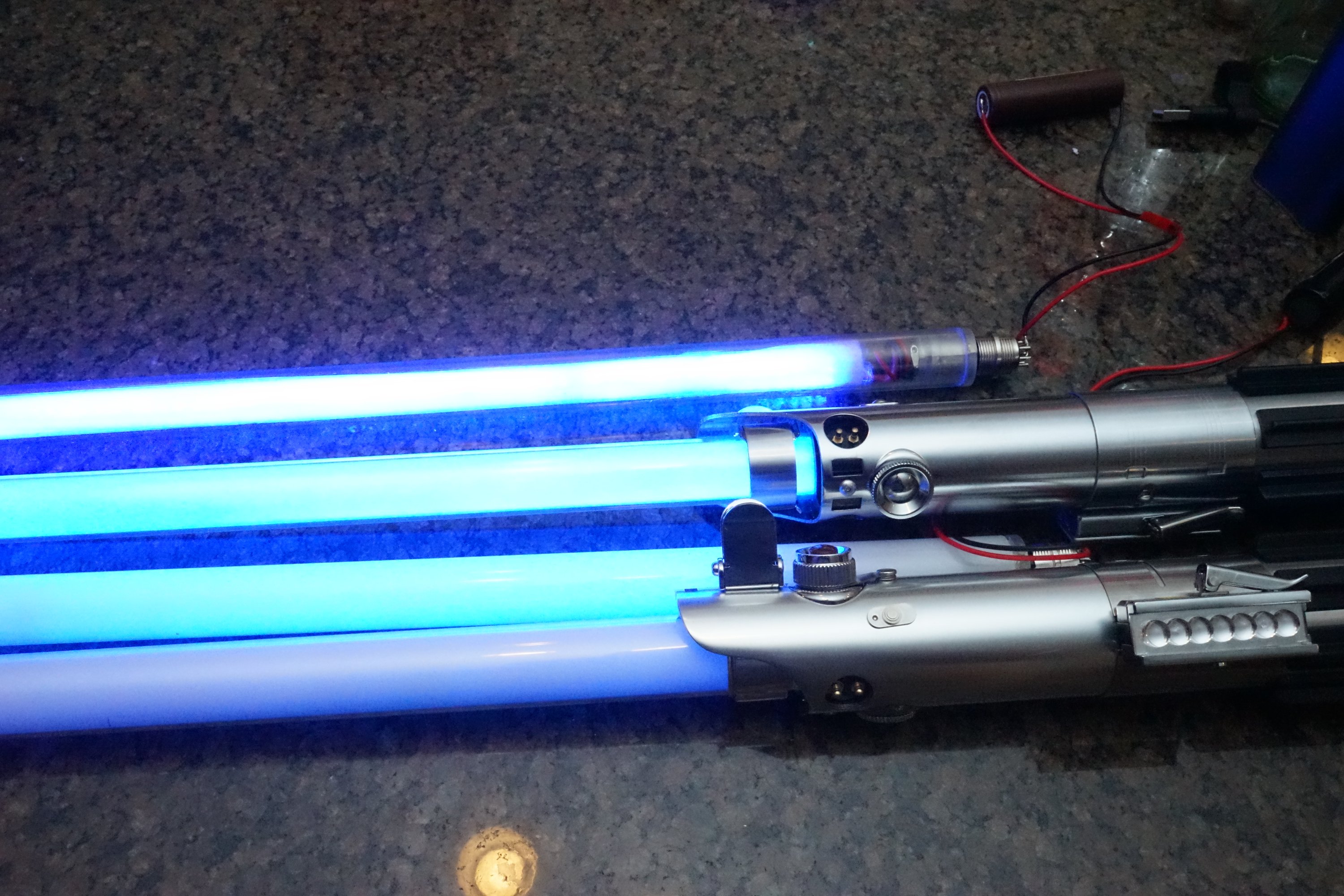

Blades, top to bottom:
  1. simple string blade made of ~150 x 30mA, diffused with packing foam only
  2. 2 x WS2811 strips, 144 leds / m, packing foam, inner diffuser tube, clear outer tube
  3. 97 x PL9823, packing foam, inner diffuser, trans-white outer tube
  4. Black Series Luke Skywalker Force FX Lightsaber
On the left, all blades are blue, on the right, blade (2) is set to white, which makes it much brighter.
