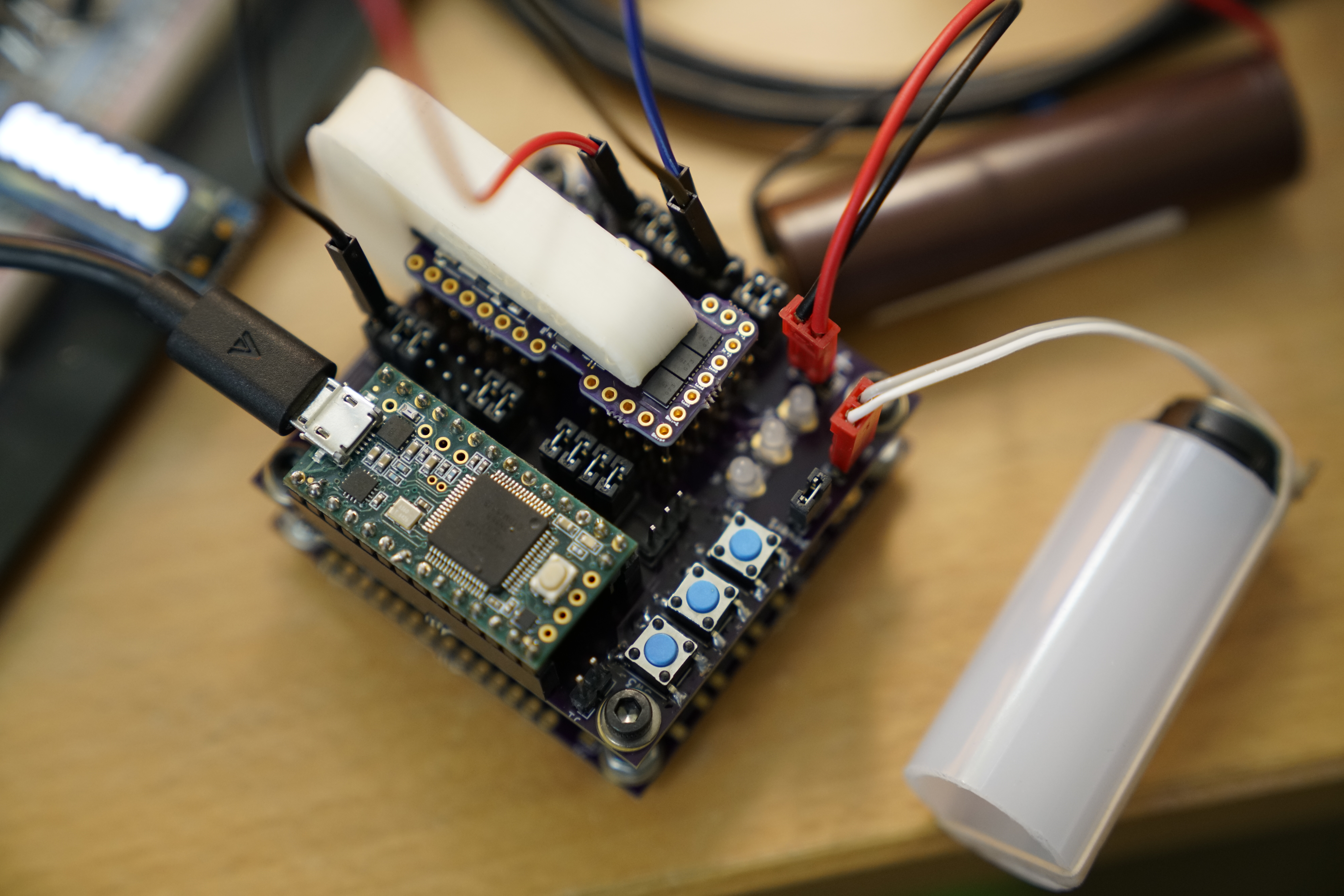

This test rig allows you to test a TeensySaber V3.x board without having to solder it to a Teensy.

Assembly is pretty straightforward. Solder all the headers, buttons, resistors and LEDs into place and trim the legs. Screw two PCBs together with the 20mm screws. The one with all the components on it goes on top. The bottom one is left completely unpopulated. Insert the pogo pins and solder them to the top board. Solder some pin haders to a Teensy 3.2, matching the female headers on the board. Put the Teensy in place and flash the TeensySaber firmware on it.

Test procedure
  1. Before you put the TeensySaber board on the test platform, measure the resistance between BATT+ and BATT-. If the resistance is basically zero, it might burn the traces on the test rig when we plug in a battery. Check the resistance between BATT+ and GND the same way.
  2. Insert a formatted SD card with some wav files on it.
  3. Make sure the battery is disconnected from the test rig.
  4. Put the teensysaber board on the pogo pins, press down and use the clip to hold it in place.
  5. Connect the battery.
  6. If your teensy is powered by usb, you should reboot it. (Either type "reboot" in serial monitor, press program button, or unplug usb temporarily.)
  7. Try "on", "off", "beep", "dir", "monitor motion", "batt" and "play somefile.wav" commands.
  8. If they all work, and behave as expected, the board is working.
  9. Disconnect batter.
  10. Rermove board.
