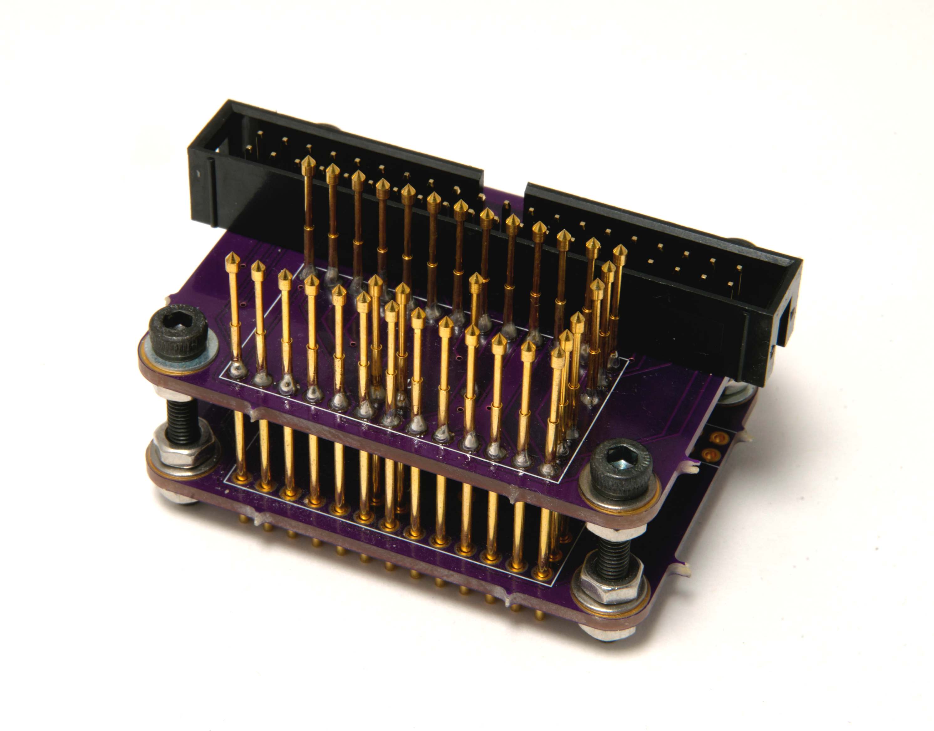

This adapter is meant to be used with the Proffieboard breakout board, but it could also be used with a raspberry pi GPIO breakout to connect directly to a solderless prototyping board.
Download Proffieboard V3 pogo pin adapter kicad files here.
What you will need:
Assembly
Solder the 40-pin header first. Note that the notch should be towards the outside, even if the "pin 1" in the kicad files suggests otherwise. Then use the M3 screws to join the two PCBs together. Insert the pogo pins, make sure they are all flat against the table. Solder pogo pins in place on the top, make sure to check for shorts!
